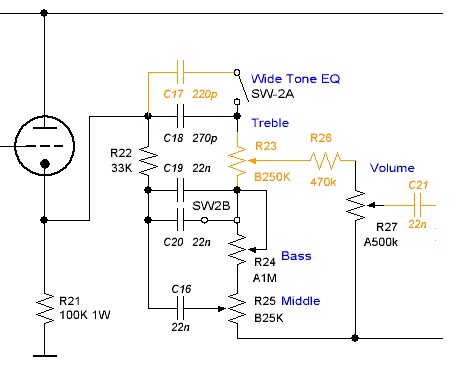

Ciao, tra le immagini recuperate tempo fa, ho ritrovato questa mod per Uberschall che veniva proposta in un forum che magari può interessarti :)
Re: Uberschall 10W
Messaggio da MapleMarco » 02/10/2014, 10:39
ti dirò, in questa testa l'unica cosa che mi convince appieno è proprio l'eq originale xD
ora, essendo in single ended si "apre" da sola come suono....ma se fosse un canonico pushpull da 50 o 100W...penso ci sarebbe un bel pò di roba da sistemare per farla suonare bene!! (alla facciaccia di bogner che evidentemente non ha dato il meglio di se...)
personalmente mi sento di consigliarla per i wattaggi piccoli.... :hummm_1:

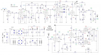

technik
Messaggi: 1
Iscritto il: 18/11/2014, 14:31
Re: Uberschall 10W
Messaggio da technik » 18/11/2014, 16:50
Hi Guys, here is my 10W Uberschall (Supersonic) - i call it UnterSchall (Subsonic) ;)
Preamp have 2x Russian 6N2P-EW tube and IRFBC40 as current follower.
I add noise gate after 3 triode, bright switch at input and cloned clean channel at 1 and 4 triode.
I change 1 katode capacitor to 2u2 because it was to much low frequency.
Signal from preamp is cut at loop in/out for < 1V rms. In this place is also possible to add parallel to 330K reverb circuit.
Power amp have 2x Polish ECL86 tube in PP with auto-bias - include master volume, presence and fatness in negative feedback loop.
Is really great and loud amp, I play it at 1x Eminence V12 cabinet.
I try also play at Celestion 70/80, Rocket 50, Tube 10, Crate but Eminence rules :numb1:
Regards.
Re: Uberschall 10W
Messaggio da MapleMarco » 18/11/2014, 20:26
It's interesting the solution of using an IRF like Cathode follower!
I used the third 12ax7 only 'cause I want to have a "free" triode to configure a fender-like clean...
My amp in fact has a SE power section, so I searched to do a really crystal clean to have a comparable volume output between lead and clean!
About first triode, If you upper the plate resistor (from 150k to 180k or 220k), the 4u7 cathode cap wanna be an usable solution to modelling an uberschall-like growling high gain!!
Thanks to have posted your experience! :numb1:

Messaggi: 9877
Re: Uberschall 10W
Messaggio da robi » 23/11/2014, 16:07
Thak you technik, we really aprreciate your infos.
The impression I always had is that they tried to go in between their own design and engl-like designs, but with a final result that has too much flabby lows.
Sounds good on youtube, good at home, not at its best live.
Tornando in italiano, in questo tipo di ampli non userei quell'inseguitore di catodo a mosfet, ma non tutti i gusti sono alla menta. diciamo che punterei ad un finale di basso wattaggio, con una PI che da armoniche presto, e con meno bassi in generale (anche sul finale, che è determinante per quel suono).
