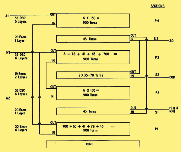

Carina questa descrizione, non so se già postata: http://www.r-type.org/articles/art-158.htm
ed anche questa: http://www.r-type.org/articles/art-140.htm
Core: 1 in stack of 1.25 in waste-free type stampings. Tappings: At 15%, 18%, 20% and 24% of primary impedance for output valve. screen grids. A Total secondary winding for 15Ω speaker, with tapping for 3Ω speaker. Brief specification: Primary wound in four sections interleaved with secondary sections. Layers separated with one turn 1-mil paper, sections separated with two turns 5-mil Empire cloth. Two turns 5-mil Empire cloth over completed winding to finish. Primary leads and taps brought out on end of one coil-cheek, secondary leads brought out on opposite side of same cheek, i.e., not opposite ends of coil layers. All windings in same direction. Winding details: Primary, section No. 1. Total 900 turns 35 swg. DSC in 6 layers, 150 turns per layer. Taps brought out at (A1) 700th turn, (B1) 765th turn, (C1) 806th turn, (D1) 884th turn from commencement of the winding, leaving 16 turns to end of winding. Secondary, section No. 1. Total 43 turns 20 swg. Enam in one layer. Primary, section No. 2. Total 900 turns 35 swg. DSC in 6 layers, 150 turns per layer, no taps. Secondary, section No. 2. Total 70 turns 19 swg. Enam in 2 layers, 35 turns per layer. Primary, section No. 3. Total 900 turns 35 swg. DSC in 6 layers, 150 turns per layer. Taps brought out at (D3) 16th turn, (C3) 94th turn, (B3) 135th turn, and (A3) 200th turn from commencement of the winding, leaving 700 turns to end of winding. Secondary, section No. 3. Total 43 turns 20 swg. Enam in one layer. Primary, section No. 4. Total 900 turns 35 swg. DSC in 6 layers, 150 turns per layer, no taps. Windings to be inter-connected as shown in diagram.
Core: 1.25-in stack of No. 29a, 0.014-in thick Stalloy laminations.
Windings (from core) See above diagram. SWG = Standard Wire Gauge
45 turns of 22 SWG enamelled copper wire, wound in one layer. 2 turns of 5-mil. Empire cloth.
1,940 turns, tapped at 390 turns, of 38 SWG enamelled, 178 turns per layer, 3-mil. paper interleaving each layer. 3 turns of 5-mil. Empire cloth.
90 turns of 22 SWG enamelled in two layers. 3 turns of 5-mil. Empire cloth.
1,940 turns, tapped at 1,550, 38 SWG enamelled. 178 turns per layer, 3-mil. paper interleaving. 3 turns of 5-mil. Empire cloth.
45 turns of 22 SWG in one layer. 1 turn of 5-mil. Empire cloth.
Test Specification
Primary DC resistance 520Ω, anode--to-anode. Secondary DC resistance (on 15Ω) 1.2Ω. Primary inductance at 5Volt, 50Hz = 75H
Leakage inductance, primary-secondary, referred to primary = 28-30 mH
Leakage inductance A1—SC1 = 10 mH
Leakage inductance A2-SC2 = 9 mH
Leakage inductance half primary to half primary = 24 mH

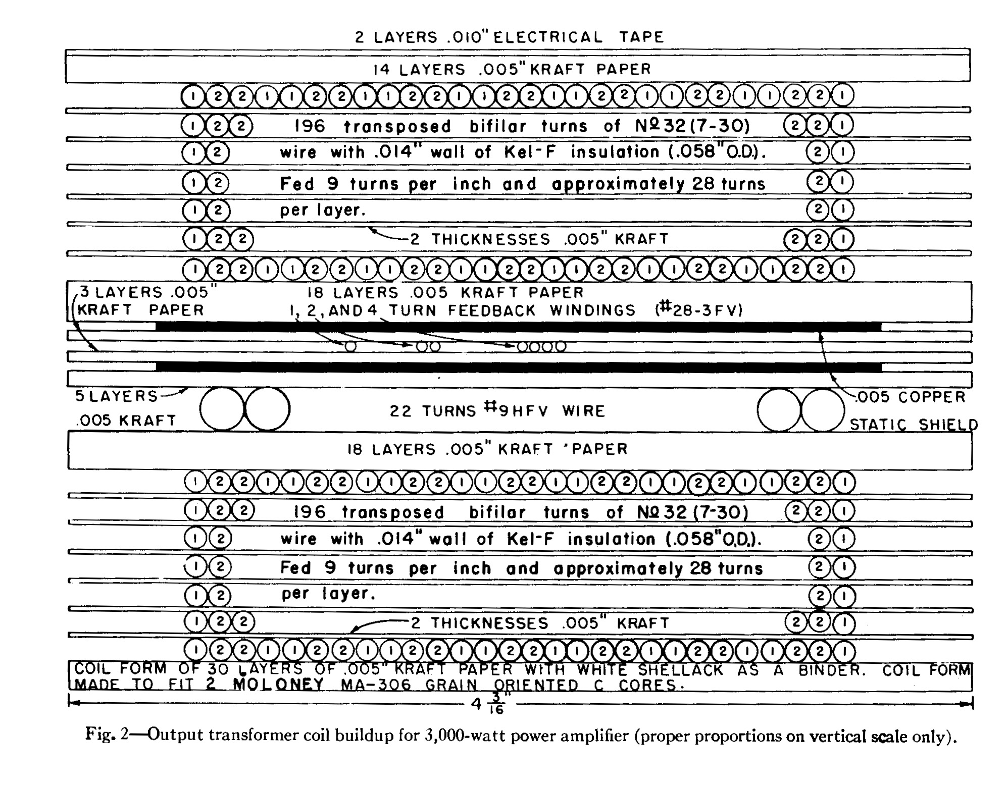

Marco, spero tu ti sia dotato di un minimo di motorino per avvolgere, o continui a fare il tutto solo a manina ?
Qui un esempio di avvolgimento su 2 x C Core, se mai a qualcuno servisse un trasfo da 3k (W non ohm di impedenza riflessa
Qui il progettino completo
Interessante notare che posizionano due anelli in foglio di rame ad uso schermo elettrostatico, feature di cui i migliori trasfo sono dotati anche oggi
