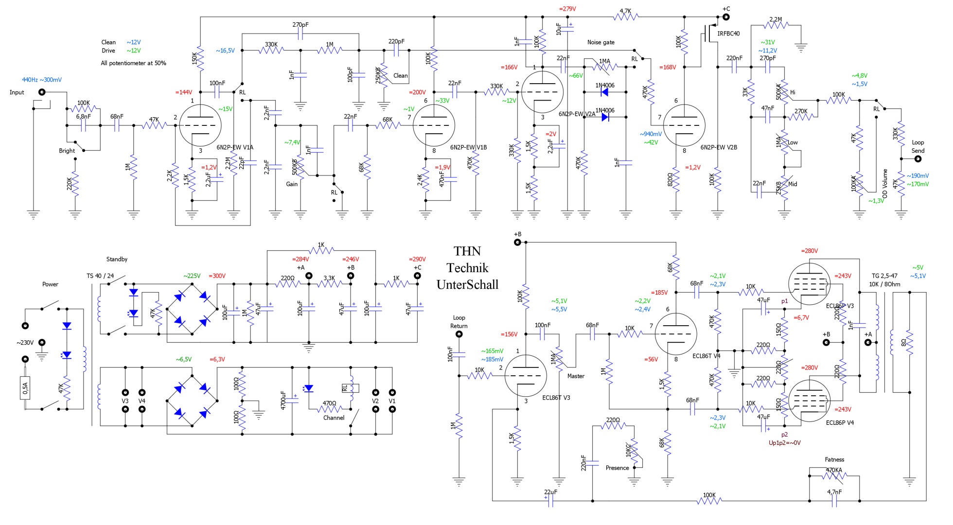

Hi Guys, here is my 10W Uberschall (Supersonic) - i call it UnterSchall (Subsonic)
Preamp have 2x Russian 6N2P-EW tube and IRFBC40 as current follower.
I add noise gate after 3 triode, bright switch at input and cloned clean channel at 1 and 4 triode.
I change 1 katode capacitor to 2u2 because it was to much low frequency.
Signal from preamp is cut at loop in/out for < 1V rms. In this place is also possible to add parallel to 330K reverb circuit.
Power amp have 2x Polish ECL86 tube in PP with auto-bias - include master volume, presence and fatness in negative feedback loop.
Is really great and loud amp, I play it at 1x Eminence V12 cabinet.
I try also play at Celestion 70/80, Rocket 50, Tube 10, Crate but Eminence rules
Regards.

It's interesting the solution of using an IRF like Cathode follower!
I used the third 12ax7 only 'cause I want to have a "free" triode to configure a fender-like clean...
My amp in fact has a SE power section, so I searched to do a really crystal clean to have a comparable volume output between lead and clean!
About first triode, If you upper the plate resistor (from 150k to 180k or 220k), the 4u7 cathode cap wanna be an usable solution to modelling an uberschall-like growling high gain!!
Thanks to have posted your experience!

Thak you technik, we really aprreciate your infos.
The impression I always had is that they tried to go in between their own design and engl-like designs, but with a final result that has too much flabby lows.
Sounds good on youtube, good at home, not at its best live.
Tornando in italiano, in questo tipo di ampli non userei quell'inseguitore di catodo a mosfet, ma non tutti i gusti sono alla menta. diciamo che punterei ad un finale di basso wattaggio, con una PI che da armoniche presto, e con meno bassi in generale (anche sul finale, che è determinante per quel suono).

Infatti, avevo anche la possibilità di farla 50W con due KT77 quella volta, ma ho optato per un finale SE...e devo dire che la cosa mi ha salvato un pò in corner.robi ha scritto:Tornando in italiano, in questo tipo di ampli non userei quell'inseguitore di catodo a mosfet, ma non tutti i gusti sono alla menta. diciamo che punterei ad un finale di basso wattaggio, con una PI che da armoniche presto, e con meno bassi in generale (anche sul finale, che è determinante per quel suono).
Così com'è, se la si suona in una sala prove sa ancora farsi valere nel mix...ma per merito del finale, non del preamp!!
Per quanto riguarda il pre in se appunto.....io credo sia volutamente pensato per Youtube, sembra fatta apposta per apparire bene al primo impatto.
