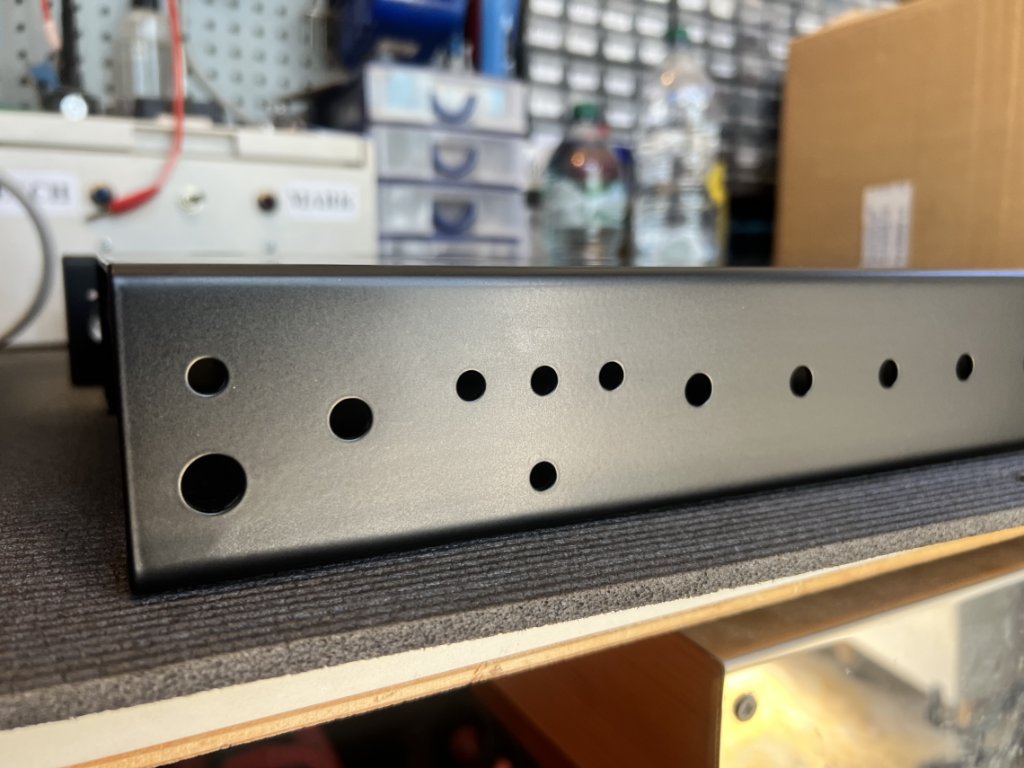

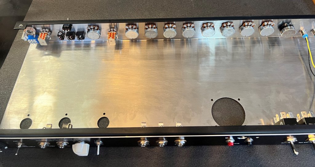

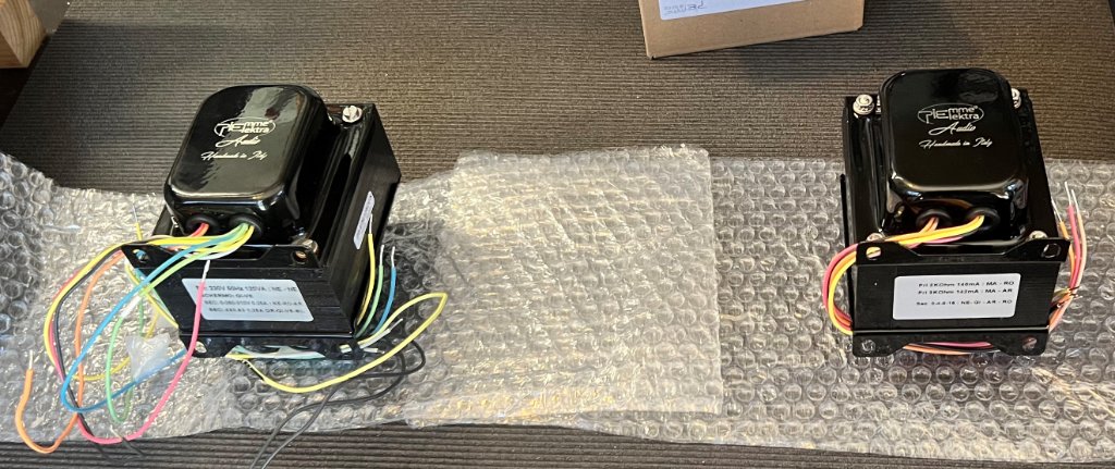

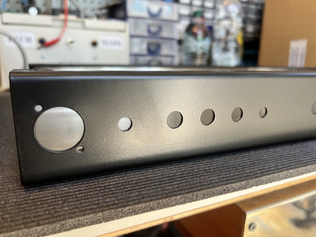

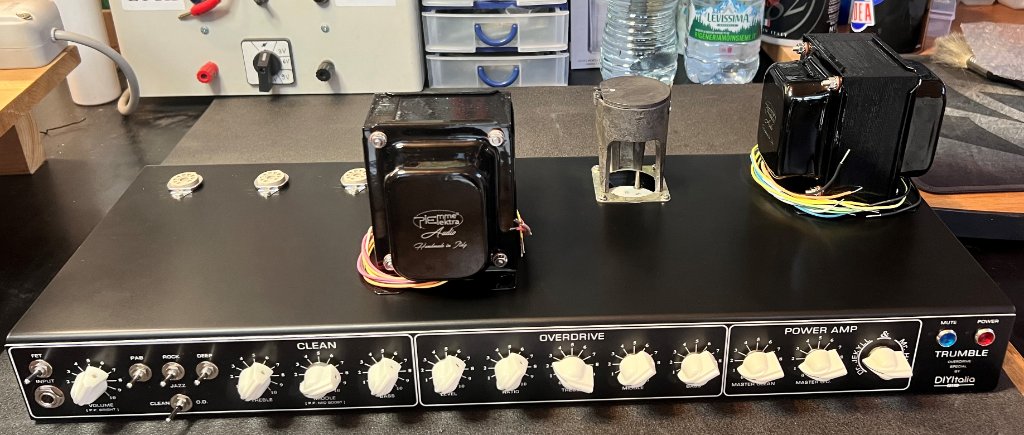

Re: Dumble SE con GU50 (???)

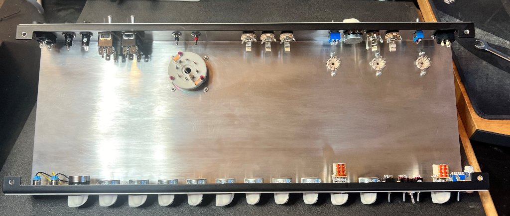

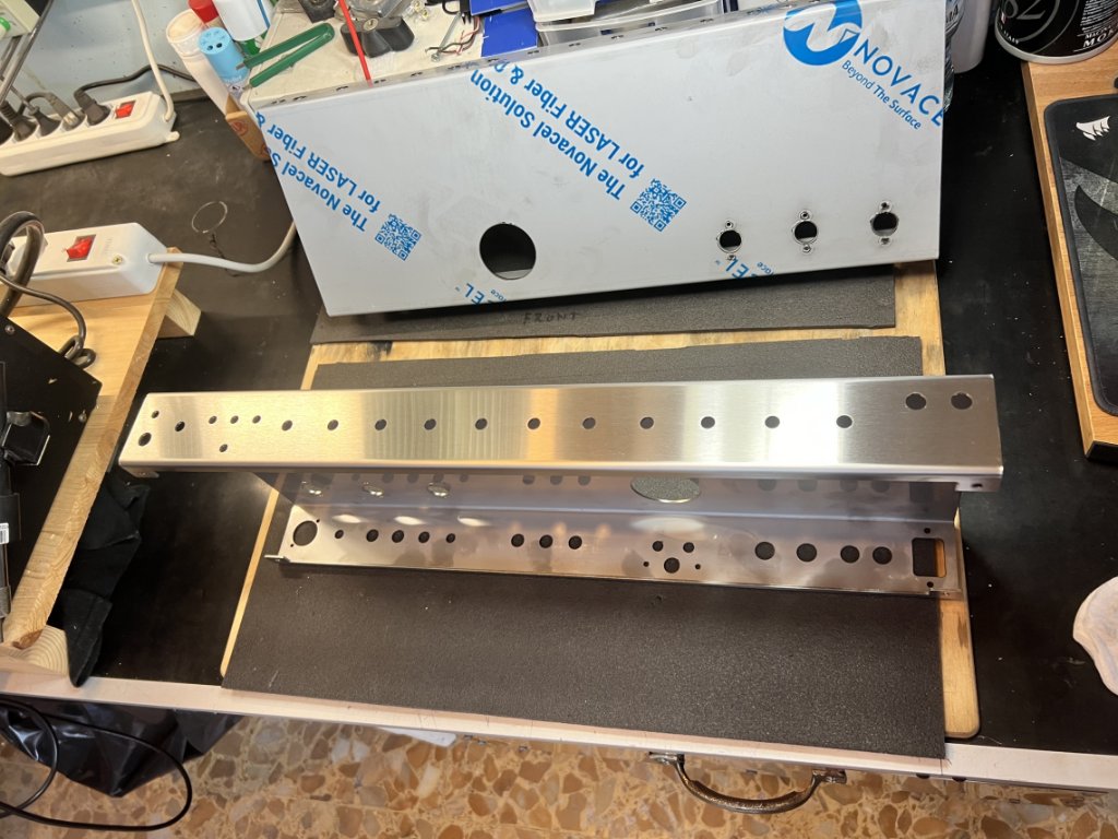

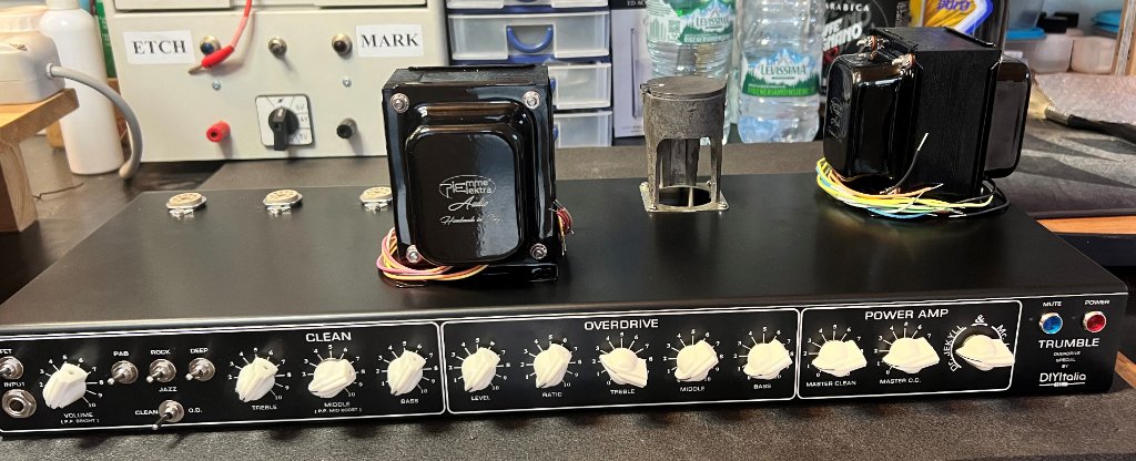

Posto qualche foto del lavoro che si sta finalmente concretizzando.
Telaio:
https://cdn.imgchest.com/files/49zc2qzeroy.jpg
https://cdn.imgchest.com/files/yd5ce8b9nv4.jpg
https://cdn.imgchest.com/files/7mmc9d5q2e7.jpg
Assemblaggio iniziale:
https://cdn.imgchest.com/files/739cx23bvz7.jpg
https://cdn.imgchest.com/files/7mmc9d5qbe7.jpg
https://cdn.imgchest.com/files/yrgcnp6bqd4.jpg
https://cdn.imgchest.com/files/y2pckg63mg7.jpg
https://cdn.imgchest.com/files/yq9c3w6bj94.jpg
https://cdn.imgchest.com/files/7ogcbmvr2wy.jpg
https://cdn.imgchest.com/files/7kzcajn96k7.jpg
https://cdn.imgchest.com/files/49zc2qzedoy.jpg
https://cdn.imgchest.com/files/4nec8p5bd54.jpg
Piccola nota riguardo a quello di cui parlavo qualche post fa sull'importanza di scegliere determinati componenti per la presa FOOTSWICH:
Ecco il perchè!
Telaio:
